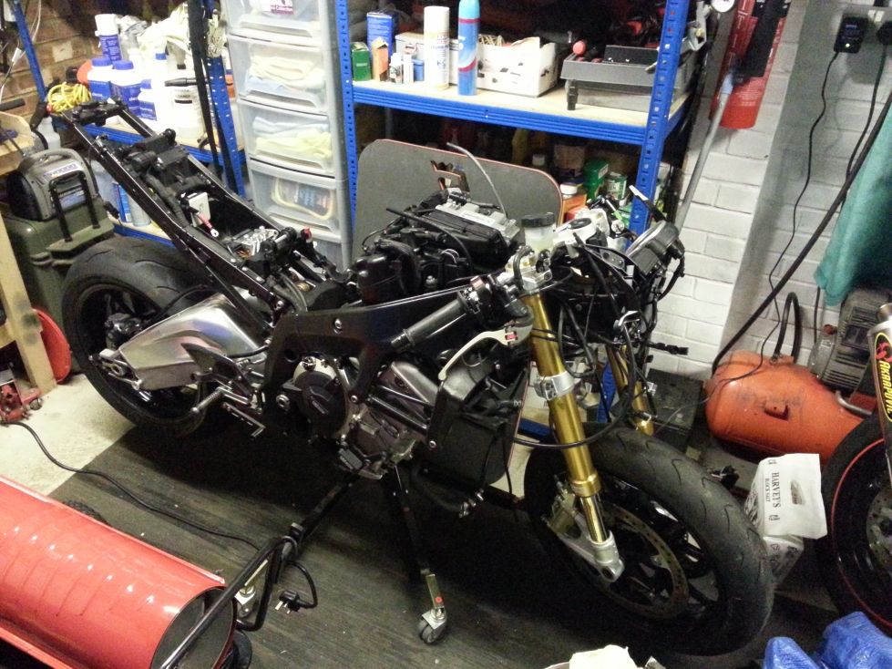

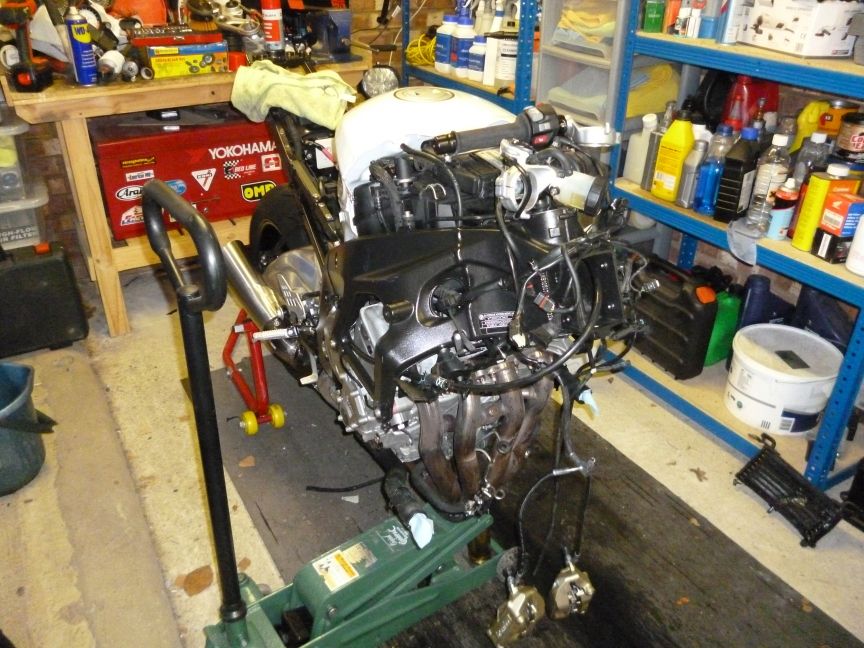

    So a few pictures, here is the bike after I got it home and removed most of the broken bits (the HP options etc were removed for insurance purposes). :whistle:

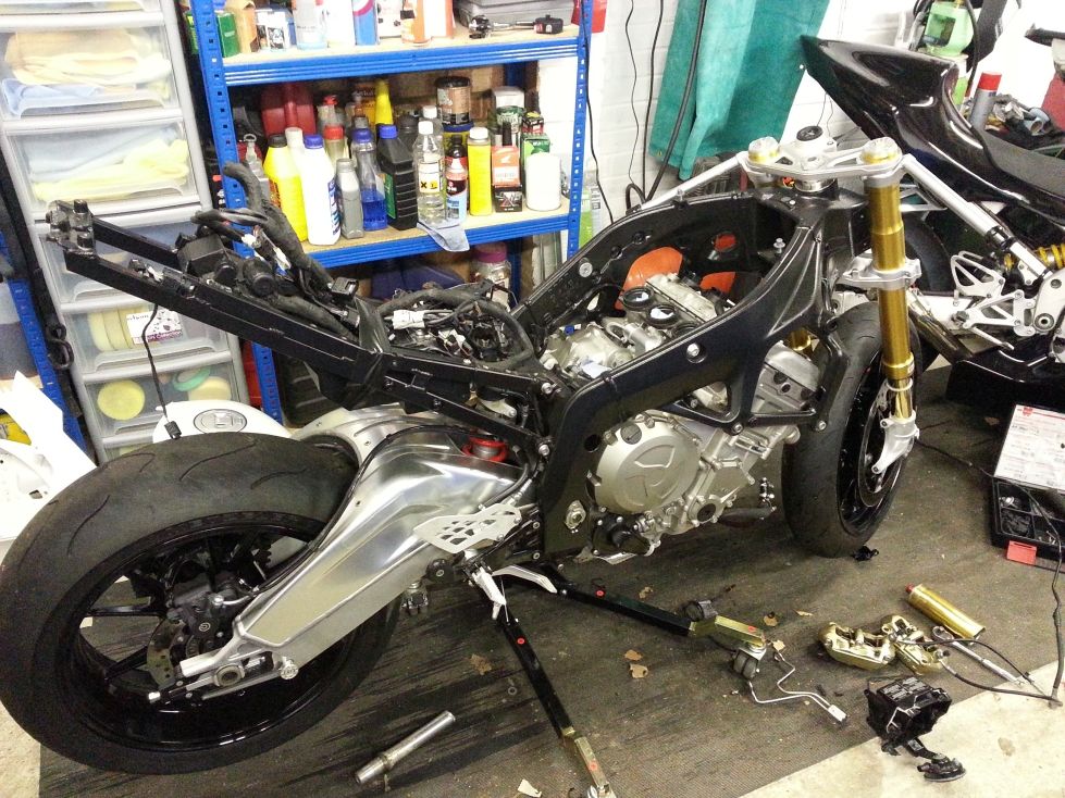

    Then I fitted some new yokes and bearings (which were changed again for the higher quality, deeper taper ones during the alignment process).
    Then once they were done I fitted the new forks and the old wheel (bent) so I could take it to Motoliner, I also had to strip out all the electrics and loom from the main frame (in case it needed to be straightened). Which is why you can see the loom folded over the subframe and taped down.

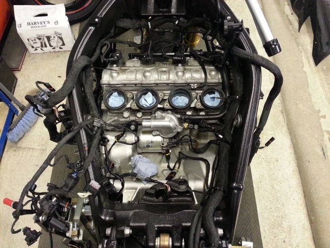

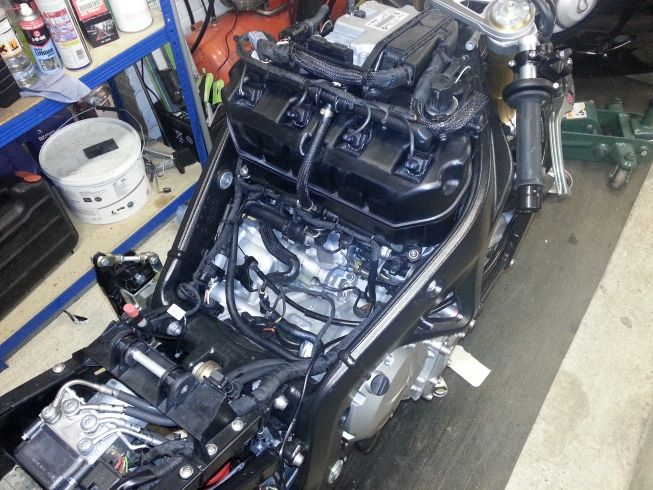

    Once that process was done I could rebuild the bike :D . I had taken about 100 pictures of the bike before I stripped out the loom, that way I could see how it laid in the frame and what went where. So I started by laying the loom in place to get a rough idea where everything should go.
    And then fast forward on a couple of hours and I've reinstalled the brake pipes and all of the wiring/throttle bodies/airbox are neatly tie-wrapped back in place. I took this opportunity to fit the K&N filter also.

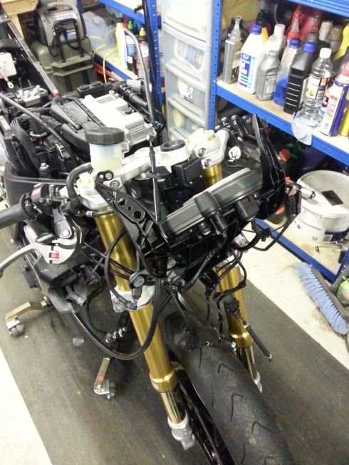

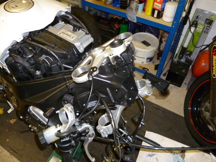

    I've then fitted the replacement clock mounting (albeit I did buy an alloy race version, but haven't used it) and replacement clocks. I've still got to sort out the wiring at the front, but will look at that once I'm happy with the switchgear setup etc.

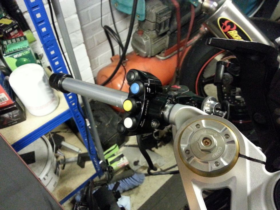

    Then I started to fit the new switchgear (as used in racing), and on the BMW this unit takes the 'mode' switch from the right hand side and keeps all the computer controls in one place. :)
    And a shot of how she sits at the moment, this was how I left it before Christmas so now that's out the way I'll be cracking on with fitting the rest of the components (albeit I couldn't resist fitting the GB covers). :)

    Soo I had a little spare time this afternoon and figured I'd do a bit on the bike, fitted the Q/R throttle and alloy housing from Alpha Racing and the other part of the switchgear kit.
    Then fitted the AR sump plug, I noticed that the magnet on this is a LOT stronger than the stock plug, so that can only help. :) Needed to drain the oil anyway to replace the oil cooler so gave it an oil change at the same time.
    Then I fitted the new oil cooler and mounting bracket, as mine was as bent as a plate of spaghetti! :D lol

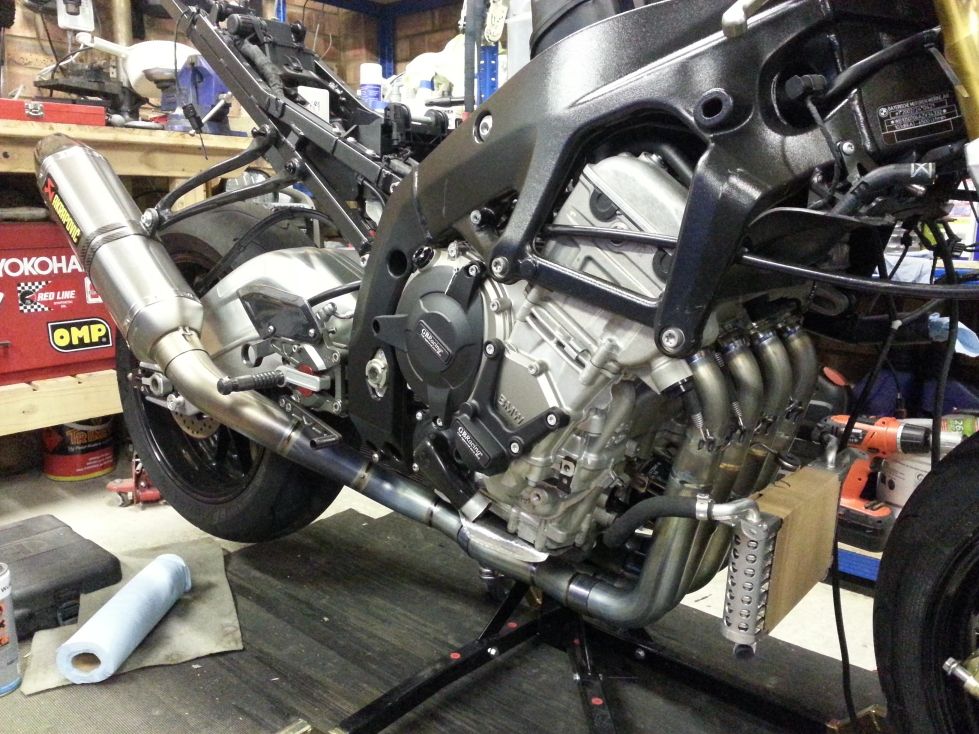

    Then I decided to test fit the exhaust system on the bike just to check all is ok, one thing I like about the Akro's is they fit together so nice, and the separate mounting brackets in the head makes life so easy. :)
